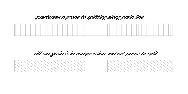

No one mentioned the skewed or riff cut as being important in avoiding splitting. I use mostly riff cut maple though I have used some BRW.

If you have quartersawn piece of wood with the grain running vertical (as in ||||||||) and a hole drilled vertically through that plate there is on way the grain could ever be anything but perpendicular to the hole. I does not mater which way you orientate the grain it is still prone to splitting along grain line. Now if you are saying that you use quartersawn with the grain in the horizontal position it will not be subject to splitting but I would imagine it wold be more dampening
Someone correct me if I am wrong here.

If you have quartersawn piece of wood with the grain running vertical (as in ||||||||) and a hole drilled vertically through that plate there is on way the grain could ever be anything but perpendicular to the hole. It does not mater which way you orientate the grain it is still prone to splitting along grain line. Now if you are saying that you use quartersawn with the grain in the horizontal position it will not be subject to splitting but I would imagine it wold be more dampening
PostPosted: Thu Aug 30, 2007 3:24 am
If you have quartersawn piece of wood with the grain running vertical (as in ||||||||) and a hole drilled vertically through that plate there is NO way the grain could ever be anything but perpendicular to the hole. It does not mater which way you orientate the grain it is still prone to splitting along grain line. Now if you are saying that you use quartersawn with the grain in the horizontal position it will not be subject to splitting but I would imagine it wold be more dampening
PostPosted: Thu Aug 30, 2007 3:44 am
With quartersawn the grain is running vertical or in the same plane as the hole. Due to loading this makes the grain more likely to split.
With riff cut the grain is being pressed into its self and far less likely to split along a grin line.
PostPosted: Thu Aug 30, 2007 4:03 am

PostPosted: Thu Aug 30, 2007 4:38 am
there is a bit of a difference in typical flatsawn and true quartersawn laid in the horizontal position.
I would suspect that quartersawn laid flat would dampen the energy being transmitted into the top because the grain line structure would be dead perpendicular to the tops grain structure. I could be wrong here. but I don't think so.
PostPosted: Thu Aug 30, 2007 5:17 am
That is what I was taught. I have never used a qs piece for a bridg plate.

Michael, I think you misread my post.  I said I make sure not to use quarter sawn.  And I said not parallel to the holes (plural) meaning parallel to the line of holes.
